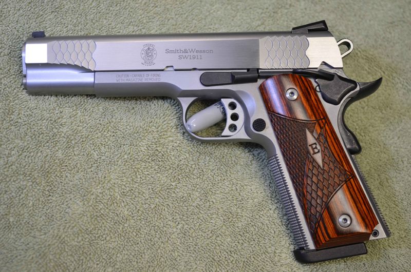

Here is a photo of my 1911.
To be honest, I was leaning towards getting a Springfield until I saw this beauty in person.
Looking forward to this weekend to see how it runs!
