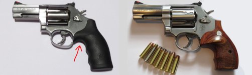

By the flatness on the underside of the grips, I meant the horizontal area right behind the trigger guard. On the rubber grips it's rounded up in, giving a nice higher grip on the gun (indicated by the red arrow in the pic). The Altamont grips leave that area filled in flat instead of rounded out, resulting in a lower, less comfortable grip.

Yeah, that curve looks like it would help reduce finger slapping by the trigger guard. I can see that I would be wrapping some 320 grit around a 5/8" dowel and going to work on your grips, were they mine. :)
You probably have a more deft touch than I. It's hard for me to get smooth curves with the Dremel. So, I usually reshape by hand.
I have also noticed that it is hard to put wood back on, which may partly explain Altamont's reluctance to cut that curve for you, especially if some other customers like the flatter shape. I dunno what the bulk of their customers like. Based on your comments, they may not either. ;)
In any event, I am pleased at being able to reshape to my heart's content and end up with a great final finish so easily.
You're probably right about the hand-shaping being a better idea.
I'll probably wait for some warmer weather and some more shooting time with these grips before risking their good looks by carving on them that much. The feel is not really that bad. I may just need to get used to it.
My finger is not getting hit by the trigger guard with either of these grips.
If I could just find someone who made a nice wood grip shaped much like the rubber one, but in a boot style... Altamont came pretty close.
I agree it is great to be able to work on it without messing up the finish. I used 400 grit on that corner and nothing else but a little hand rubbing with whatever oils may have been on the gun and my hands at the time and you can't tell there was any work done even under a magnifying light.
