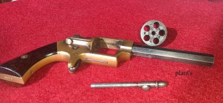

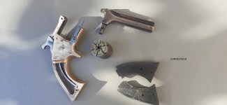

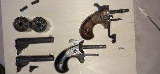

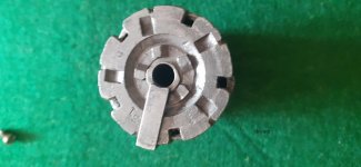

here are some examples of rollin white patent circumventions,
-Brooklyn slocum (Brooklyn Firearms Co ) 32 rf
-Moore ( Moore's Pat. Firearms Co. Brooklyn, Ny & National Arms Co. Brooklyn, Ny )
32 teat fire Frontloading
-Connecticut arms co (conn arms . co , norfolk , con ) 28 cup primed Frontloading
-Plant's manufacturing company (Merwin & Bray New York) 30 cup-primed Frontloading

examples showing that the cylinders are not pierced all the way through
