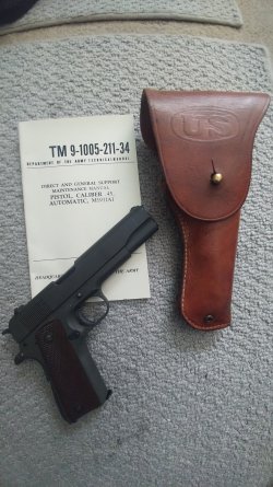

Any tips or tricks to fit a Leather Holster?
Nov 26, 2023
85
210
Pacific Northwest
Any of you have tips or tricks to get an old holster to fit a pistol? I have a WW2 Boyt Leather holster for my 1911, but it must have shrunk with age. I cleaned it up with saddle soap on outside. My 1911 will not fit all the way into it. I don't want to put anything on my pistol, or leave it in the holster long term to make it stretch.
any ideas appreciated.
Jeff

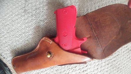

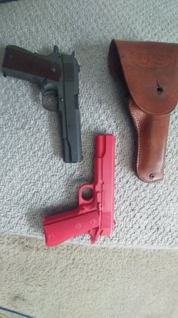

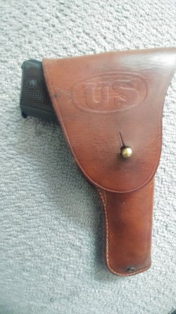

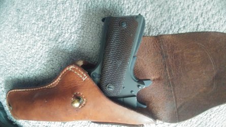

Update! I had some free time and was able try the warm water trick. I was fortunate enough to have a friend send me a plastic trainer 1911 to use. It worked great, warm water with soap, softened enough to shape holster. I let it set to dry, then just left the pistol in for a week. Now it fits great! And no worry about my Ithaca being wet.
