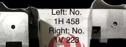

Was okay with 50gr bullets and the pic of the breech block
compared to the No.1H block ain't pretty. :(
Might send the block to Ruger at some point and may
re-chamber or new barrel/caliber.
Will run some 40/45/50/55 bullets soon and see what's up.
