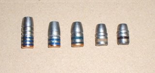

Ajpelz; I shoot many different weight bullets in my 44 Mags, and depending on the weight of the bullet (heavier the bullet, the longer it is) and the cylinder length of an individual revolver, the OAL does change. I not only shoot Smiths (44 Mag and Special), but Super Blackhawks, and Redhawks as well, and my bullet weights range from 240 to 405, so depending on the weight and the gun that OAL does change.
