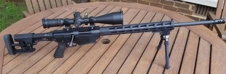

I shoot and reload both 6.5cm and .308. The 6.5cm in my RPR is unbelievably accurate. My absolute best long range gun. Eggs at 300 yards with ease, 1000 yard 12" steel no problem. Far better ballistics then the .308, but I do love shooting the .308 in my POF Revolution DI too.
I started reloading the 6.5cm about 3 years ago taking into account different powder charges as well as bullet jump to ogive. When all the smoke cleared I had a great recipe. My last test target below at 100y with reloads. Still working on the .308 development. Both are enjoyable and don't have to worry about the ridiculous prices. I will give a nice shout out to Hornady, I was able to achieve with factory ammo .312" moa with 140g ELD match in the RPR. That was my goal on the reloads when I started. Ended up with .25" moa...baring that one hole where I twitched lol. Great cartridges, both of them, but I prefer the 6.5 for serious distance.
