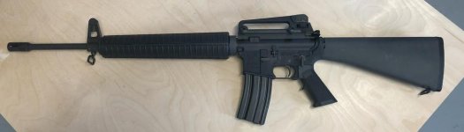

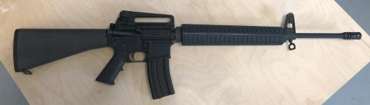

My M16 clone is 20" 1:12 twist chrome lined and will eat Federal .223 Remington 55 gr. FMJ all day long, but if I'm really interested in sweet accuracy on the 200 yard reduced size zero targets, set up actually at 100 yards, then my rifle really likes "Frontier" (Lake City M193) 55 gr. FMJ BT at listed 3240 fps.
It is me with same old eyes, same open sights, same sitting at same bench, same day, same wind, etc. so a "teeny edge" seems to go to the Lake City stuff.....maybe it is the boat tail...I don't know.
Either way...tons of fun...with or without its' "father" along with a bigger boom, more expensive ammo, and a ping.:D
