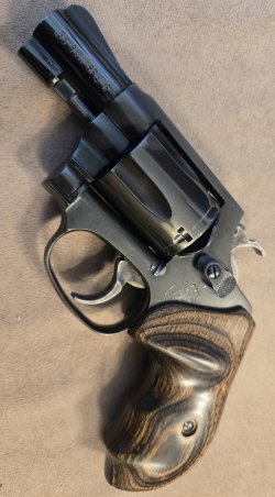

My model 36 has eaten standard pressure 158 grain SWC loads for years. It hits pretty close to point of aim with them. I normally keep some standard pressure hand loaded 157 gr wadcutters (Matt's Bullets) in it all the time. But I've been watching youtube videos of gel/denim testing showing how wadcutters blow right thru and keep on going, meaning that they aren't dumping all their power inside the target. They may do more damage than SWC, round nose, ball, or unexpanded hollow points, but they still waste a lot of their power by over penetrating. So... I've seen some youtube videos where various factory loaded hollow point bullets are used. Most of them fail to expand at the velocities that can be achieved using normal pressure, or even +P ammo. Some of this is because the denim fills up the hollow point so it can't do it's job. But Hornady's 110 grain FTX +P ammo expands reliably. The main question I have with them is, will they hit the point of aim? If so, great. If not, then I think I'd better stick with the WC ammo. The only way to answer this question is to spend $40 on a box of this ammo and see where it hits.
After all the answers to this thread I'll not worry about the safety and wear and tear on my gun with +P ammo. If it hits point of aim I'll start keeping it in the revolver. But I won't shoot much of it, cause it's too expensive.
