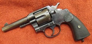

This is my 1915 Colt NS in .455 Eley.
A box of the CIL ammo came with it.
I reload for it. I found correct 265 gr. round nose, hollow base and 250 gr. hollow point "manstopper" bullets at Reeds Ammo and Research.
I just looked on their website and they sell loaded ammo with both bullets for $65/box of 50.

.455 New Service

This one was made for England circa 1915, IIRC. It was refinished when I got it, I added the repo hard rubber stocks in place of some brown plastic ones that I broke.
I think Fiocchi still makes .455 Webley, but it is Mark II. I like the longer case. Interesting too that Dominion Mark I used the LPP versus Fiocchi's SPP.

Like the Colt New Service.
