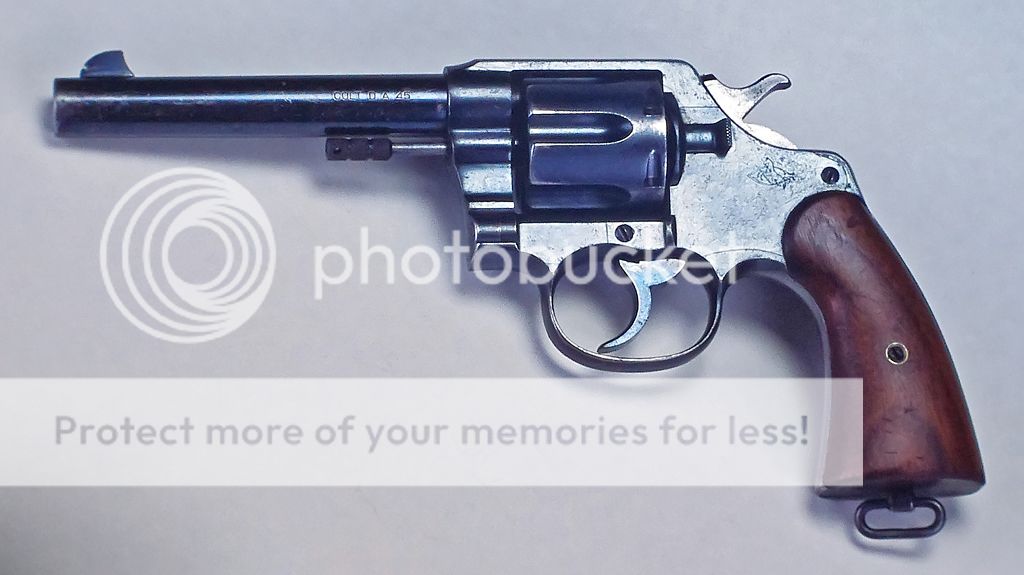

This is my 1909 Colt, a standard Army model. While it will accept and fire regular .45 Colt cartridges, a special military load was called for as an aid in extraction. This one was made by Colt in 1910.
The military cartridges have rims that are slightly wider in circumference to avoid the extractor slipping over the smaller standard rims and causing a jam. Just take it easy when extracting regular .45 Colt empties and hold the barrel vertically.
John
I have two of them, both Army. They were designed to use the .45 M1909 cartridge. Same as the .45 Colt, but with a larger rim diameter for improved case extraction. Military ammunition was always loaded with smokeless powder. So far as I know, it was made only at Frankford Arsenal. As noted, the military sent most of them (not all) to the Philippines, few ever returned to the USA. That is why few are seen today.
