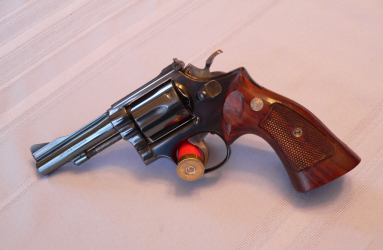

Okay. Since we are coming back to this thread, I'll add a photo.
This is a Model 15-2, shipped in June 1966. It has the target trigger and hammer but came from the factory with Magna stocks. I have the original box and stocks. The GA target stocks shown are from a Model 19-2 of the same era. The picture shows the way this .38 Combat Masterpiece was configured when I got it from my dad a couple decades ago. I didn't find the box and Magna stocks until after he passed away.

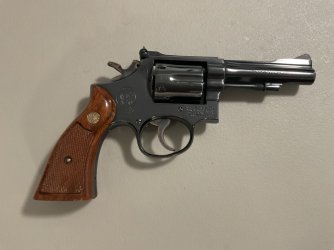

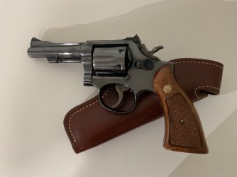

My 1974 Model 15-3. Factory grips numbered to revolver. .375” “semi target” hammer.
