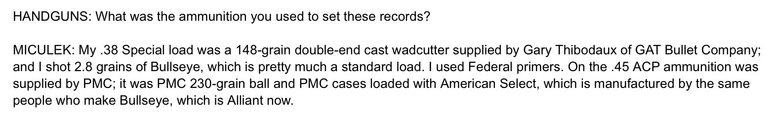

I've been watching jerry miculek videos on YouTube lately. There is no doubt that he is amazing but my question is this. I'm sure they are shooting reduced loads. Does anyone know what load Jerry or any of the shooters use or at least the velocity they reload too. I'm assuming they are shooting 357 magnums that are reduced to 38 special velocities.

It is known that he used the factory, Brazilian ammo, MAGTECH, for all his matches
in the old days.
I don't know what he uses now.
Thanks everyone for your responses.
Glen thanks for the link. It tells me what I wanted to know.

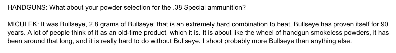

2.8 grains of Bullseye with either a HBWC or DEWC has been a standard load for more years than I can remember. Use it in both my 52-1 or my K Frame PPC every time I shoot them.
