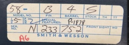

That box indicates your Model 58 was shipped with Plain Clothes Magnas. The PC Magnas had the rounded bottoms so as to be less likely to print under a covering garment.
Purchased a model 58 with box at auction. Gun's in very good condition. Guessing late '70's manufacture. My question is about the grip. Is it actually the correct one? The seller was unsure & I can't decipher the markings on the box.
Thanks!
Possibly late 1977, but yours is probably somewhere around 1976. N200000 range covers 1974-77, and M58 production ceased in 1977.
The rounded-bottom PC magna is the correct stock. It's correct that the M520 and M58 were the only N frames with these stocks. The ones on the M520 aren't quite as nice, the feel is a bit more squared than rounded on the portion you hand grips. You don't see it easily, but you feel it when gripping them. The M520's weren't manufactured until two years after the M58 was discontinued.

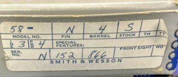

Sort of beating a dead horse here; but attached are photos of the end of your box, mine, and my nickel plated Model 58. It quicky became my favorite revolver. It's awesome. I find the thick Magnas that came with it to fit my hands perfecty.

I notice some slight differences in hammer profiles which I had not seen before...Thanks for that pic...:cool:...Ben
The hammers should be the same. I think the spur on the M58 in that picture may be bent ever so slightly, or it could be the camera angle.
