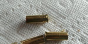

I got 6 new load rounds and numbered the cylinders, fired the lot and then measured, they extract fine, it is the auto eject model and is 32 s&w and these are longs.
The pictured case at the top is the worst, the case is 0.336 just ahead of the rim, the bulge about i/3 of the way is 0.343
The deformation is not uniform all around but more on one side, the other cylinders have a little more or less than the 0.007 on the worst.
It may be much ado about nothing, but my other 32's do not do this and this is one of the tightest H&R actions I have.

If factory ammo, you might try to find the lowest pressure load out there,
to try to fix the problem.
If you are loading, maybe a lighter load of fast powder or try a starting load of slow powder to see if the case will stop swelling.
Good luck with your problem.
Thanks

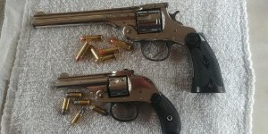

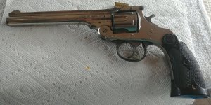

I'd then place the blame on someone lengthening the orig 32S&W chambers (S&W Short) to S&W Long. Do the chambers look reworked when you look inside of them? polished rear section but rougher forward section with tool marks..
The bbl marking is '32S&W ctg' which was the designation for the 32S&W Short.
I'd stick with the 32 Short, or reload the 32Long down a bit and accept the bulge as part of the set-up as it is.
Your H&R looks like it's in nice shape. They are very nicely finished revolvers. I had a 32cal that looked a lot like that one some years ago but in a nickel finish.
Pretty sure H&R never used cylinders long enough to ream to a long 32, I have several shorts and they all have short cylinders.
Pretty sure it's just sloppy on this gun for some reason.
Thanks for all the input, I'll shoot as is with my typical mild loads.
