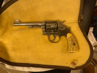

Hello all, I just inherited the above detailed revolver with the serial number 651409. No box, just the revolver. It is nickel plated (I think), the grips have an oak branch and leaves design, and a swivel mount. If anyone can give me any specific details on this wheel gun it would be greatly appreciated.
Based on the caliber, the lanyard loop, and your description of the engraving it sounds like it *might* be a Victory/British Service Revolver that was engraved and nickeled in Germany post-War.
I assume there is a "V" before the digits in the serial number?

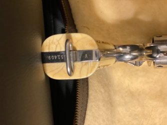

I'd also expect there to be a "V" on the butt. I agree that we really need to see a photo (or several such). I'd also like to know if a .38 Special round will chamber.
Thanks for the replies and your help. As you can see the butt stock has a V in front of the serial number. The barrel is 4.5 or 5" long. It is a 38 caliber as a 38 special round will not fit in the cylinder.

I just got this notice from the SWHF on date and service:
V561409 is a "Victory" revolver that was made during WW2. That particular revolver was a Navy gun that shipped in May 1944.
That doesn't look like the number that is stamped on the butt. Please post another picture of the butt and a picture of the number stamped under the barrel.
That's not a Navy gun and the number that you quoted doesn't match what you showed in the pic....It looks like you might have accidentally inverted the first two numerals.
Thant's my dyslexia again. The SN was actually V651409. Otherwise the numbers match on the barrel (with a P+Star), yoke (KO 98764) and cylinder (651409). I did the pin test on the inside of the grips and nothing melted. The yellowing on the outside, fabed white inside, and the grain on the bottom seem to me as real ivory. I'm thinking about putting the grips on my pawn shop engraved 38 special and selling the BSR with original grips. Thanks to you sharp eyed members for taking the time to help me out with identifying the revolver.
The stocks sure look like ivory. One way to make sure they are not resin or other man made material is to heat a needle red hot and touch it to some obscure place like the under side of one of the stocks. It won't melt ivory.
Red hot pin test had no melting, smoke, or even a mark on the grips.
