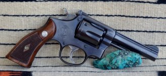

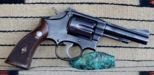

2 early post war 4 inch K frame 22 LR
1. 4 inch lettered Model K22, not many of these around
2. 4 inch pre Model 18, lots of these.

While there may be outliers, (S&W, after all) another difference is Mod 18 being a Combat Masterpiece has a Baughman ramp front sight, and the Mod 17 Target Masterpiece has a Patridge front sight.
The 6" post war k22 was introduced with a new raised narrow rib barrel abt 1946.
There was a small amount of 4" versions made by SW around 1948 to test interest and or fill a small order, those early 4" guns had the same barrel and front site as the 6" which is the one on the left in Rdrbills two pictured above.
Sw made the 4" a regular cataligged item in 1950 and introduced it with a longer fs ramp and Baughman blade like the one in Rdrbills right picture, at the point in 1950 the 4" and 6" still had the same narrow barrel rib and frame .
Around 1954-55 Sw introduced a new wider rib 6" and since it's rib was wider at the back they no longer "Notched" the frame, IIRC the frames top is slightly bead blasted vs polished to match the barrel rib as well, at this point fwd the 4" and 6" had different frame styles and barrel styles.
This continued into model numbers all the way until the end of the 17-4 and 18-4.
After that the Model 18 was dropped and the 17-5 was offered in 4" , 6" and 8,3/8" with a new wider rib barrel with a thicker profile.
During the 17-6 revision it changed to a full underlug barrel in different lengths.
