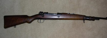

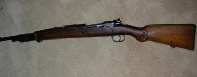

This is the only 7X57 rifle that I have. I bought it at least forty years
ago at a gun show. It's an FN large ring 98 Mauser carbine made for
Venezuela and has the Venezuelan crest on the receiver ring. The
barrel is about 17.5" long and has an excellent bore despite the usual
dings on the outside of the gun. Some previous owner thoughtfully
put a thin coat of clear varnish on the metal to help protect it I guess.
Someday I may work up the ambition to remove it.
