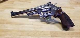

A couple pictures to try and help
#1 -32 RP original nickel
#2 44 HE aftermarket nickel
#3 K22 factory nickel, not original
#4 357 Magnum original nickel
#5 Rp target, not original nickel.

Obviously I was looking at a specific gun. A 5-screw 44. Here is the left grip frame:
I think this indicates factory re-work of some kind in 1966.
The trigger, hammer and sights are NOT nickel. There is no “N” on the cylinder. There are two tiny pits on the left side plate that look like they were there before the nickel was applied. The logo on the right side looks a little shallower and a bit softer than a contemporary S&W right next to it. (Thanks for that suggestion!) My current guess is that the gun was refinished by S&W after there was some damage to the original finish. It looks pretty good except for some unfortunate and peculiar scrapes along the top strap where the finish isn’t polished.

Can we see the rest of the gun?
Robert
The star and the date would indicate it went back for factory servicing and it might have been refinished as part of that service.

Just FYI here is the listing for the completed auction. 4” 5-screw 44 Magnum that went back to Springfield in 1966. Hammer price only $1,900 despite $2,500-3,500 estimate.
EARLY NICKEL 5 SCREW SMITH & WESSON PRE MODEL 29 - Poulin Auctions
I am saddened to point out that the description was “updated” to include the grip frame markings and factory service only after I asked them to remove the grip panels at the preview last Wednesday and expressed my concerns about the nickel finish. They had to take the grips off to read the serial number…
No, I did not bid on this firearm or any other in this auction.
Good job, Chip. Otherwise someone most likely would have paid a lot more. So seems like a blue gun that went back for nickel finish. Also missing the cokes.
