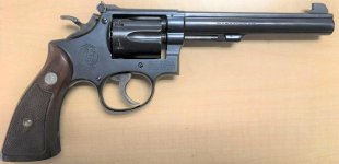

I think this is a satin blue gun. It is difficult to photograph. It is a flatter finish, sort of like a Model 28. I very credible source (Jack) suggested that it shipped in late 1951. Bought this at the 2024 SWCA Symposium. It's a beauty.
