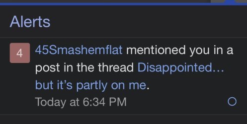

Dude! You scared the bejeezus out of me when I saw this pop up in my feed:
I almost had to take one of my jumpstart pills….then I read your post LOL.

Ha! I should have thought about that! Sorry to give you a startle!
