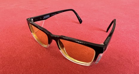

Years ago, I worked with my optometrist set up my shooting glasses so that my right eye focus was on the front sight of my 6 inch shooting guns. The left eye focused on distance, at that time there was no correction for distance. I also had bifocals cut in the lenses for close work. The target is always going to be fuzzy if your focus is on the front sight. That has worked pretty well until lately, when indoor shooting the old eyes were having a hard time finding a black sight on a black target. I installed a green dot Holosun on my 627-5 which works great for indoor shooting. I have to admit, it is more costly than the Walmart solution!
I've been near sighted, corrected with glasses, since I was 12. At 73, I wear bifocals, and have for the past 25 years or so.
I can see the front sight without glasses. (Can read without glasses, too, if I pull the book up to within 20 inches or so of my eyes.)
For shooting, though, wearing my bifocals, I could not see the front sight clearly. I went to an ophthalmologist who is also a shooter, he was recommended to me by my shooting club as the go-to guy for prescription shooting glasses.
He provided me with prescription shooting glasses where the focus of both lenses was between the front sight and the target. The idea with this approach is that while you can see neither the front sight nor the target perfectly, you can see them both well enough to shoot well.
I used these for about six months, but was not really happy as I wanted to see the front sight crisply.
Reading on the forum here, I came across a post on this topic. I think it was by Ivan, wherein the poster said his father-in-law had been a champion pistol shooter with prescription shooting glasses whose approach was to have his dominant eye lens focussed on the front sight and the other eye lens focussed on the target/infinity. The poster explained that one's brain soon adjusted to this approach
I liked this idea, and discussed it with my ophthalmologist. He was skeptical. He said many/most people could not handle the discombobulation that it caused. I decided to try it anyway.
It works for me.
When I first put the glasses on, it is a little weird. But within ten seconds or so, my brain adjusts and it feels normal. I can see the front sight just fine, as well as the target. I see both, clearly and crisply.
I like these glasses a lot better than the first set of shootong glassses that were focussed inbetween the front sight and the target.
