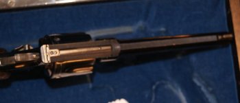

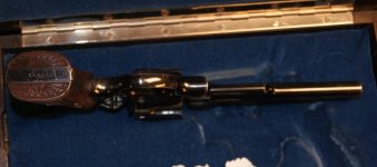

Hello everyone, thank you for having me,
I come to you with a gun that I was at first excited to come across as a potential barn find, but as I look closer at what I've got in front of me I'm finding some possible red flags, and I'd appreciate the help of a few more learned eyes and opinions.
At this point i'm about 60/40 that its a fake.
Here are the pictures i've got to work with
So here are the red flags...
The serial number on the butt is very deeply struck. I've never seen one that deeply struck on a S&W.

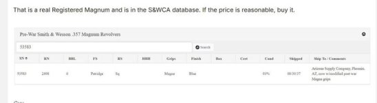

The registration number in the frame of 2948 does not match the registration number listed in SWCA's database for that serial number 53583. 53583 is listed as Reg #2498...the middle two numbers reversed.
Typo?
Or faked RM with restamped serial numbers?
Welcome! The gun appears to be an original prewar .357 Magnum; it would be very difficult to alter new parts or reproduce them to mimic one of these.
One possibility is the registration number reported to the gun is a typo in the database. I cannot see the serial number in the images but they were deeply stamped in this time frame, and a 3 can easily look like an 8, or a 5 like a 6, or a 6 like an 8.

It looks like a legit pre war magnum to me. But I'm on my phone and I can't zoom in to see details very well. Curious if the hammer has the concentric grooves? The rear sight appears pre war appropriate. I can't see ejector knob very well. Nor can I zoom on side plate fit or logo for signs of refinish. Not sure if just my phone or need clearer pics. The serial stamp on bottom seems ok compared to mine but again a little fuzzy on my phone. The stocks I can't tell if they were modified original pre war magnas or later post war. And Not sure if Mr. Jinks was embossing letters during this time period. Is your letter is embossed ?
The experts will comment soon but unless I'm missing something it seems to be a legit pre war magnum.
It looks like a pre-war magnum with post war grips on it.
They aren't "faked" by anyone. They are valuable, but not valuable enough to justify the level of work required to fake the work you see here.
That's not to say that a gun may not be "right" as in all factory original. These guns saw a lot of use and repairs and upgrades. The grips in this case are certainly something from after the war.
If the gun was a good price, or is a good price, its absolutely something I would snap up. Looks like a real nice shooter grade registered magnum from these somewhat fuzzy pictures.

I apparently transposed two digits in the REG# when I originally entered this gun into the database. I also corrected the front sight and barrel length entries. The database entry for this gun now appears as follows:

This example also goes to show that the discrepancy in Registration number on OP's letter vs. the one on his RM is most likely a typo.
