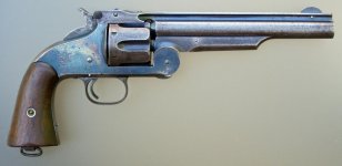

Here is serial number 438. It has had its 8 inch barrel shortened to 6 1/2 inches - a common practice. It has seen heavy use but is still functional.
The first issues are numbered with assembly numbers like the commercial First Model Americans No 3’s being manufactured at that time.
The full serial number is found on the butt in front of the lanyard screw and inside the right grip plate.

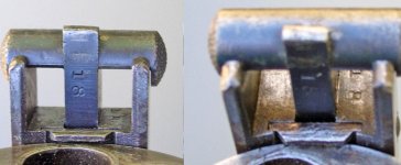

Right side hinge comparison Serial №13300 left, Serial № 438 right

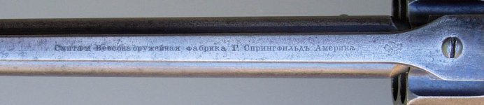

Line address and Russian acceptance on the barrel rib

All are marked with the Cyrillic address and the KO acceptance stamp.

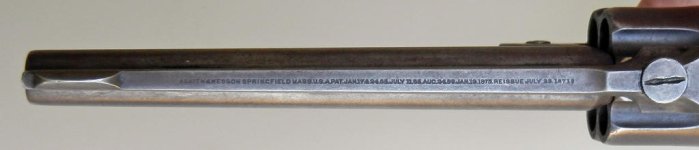

"Reissues" were marked for military contracts. It wasn't a good idea to put "Russian Model" on the barrel of a revolver going to Turkey - a long standing enemy of Russia , or going to Japan an emerging enemy.

A "reissue" 3rd
Since "Reissues" were for military customers, they have full serial numbers - not Assy numbers. The Russian models were mostly marked like the Americans with Assy numbers (there are some exceptions, especially Russin Contract rejects).
