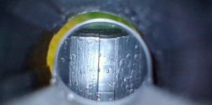

I didn't respond initially after seeing the photos of the bore, as I have never seen anything like that in my 50 some years of shooting. When I said that I had looked at a couple of new model 41 pistols on display at Sportsman's warehouse and thought they looked nice, I never checked the bore as I would not have expected to discover such a condition.
As others have stated, the stiff safety and stiff trigger guard movement for take down are totally normal, but obviously the bore is not. For those who try to determine in what year of manufacture did the model 41 become suspect, that's not so easily done. My 2007 model has the dull blue finish but otherwise shoots as well as my older model 41 pistols from the 1980's did. Smith & Wesson should absolutely replace the barrel with a new one, and it would be nice if that could be done without returning the whole pistol, but I question whether they would do that or not.
I am very sorry that you are having to go through all of this. I will be interested in hearing how Smith & Wesson resolves this.
That bore looks weird (in a bad way) I guess see how it shoots but a new barrel or having the existing barrel relined is a option. As far as function 41's seem to come in two flavors, finicky and no problem. I think the extractor is the most common reason for jams on these pistols not the barrels. I have a late 70's version that came with a 7.375 inch barrel and it is extremely reliable with any ammunition that I have tried in it. On a lark I bought a new 5.5 inch barrel and a used 5 inch field barrel and they all function fine even though they are all different ages. The other item that can cause problems is a bad recoil spring. Anyway there is a lot of info out there regarding making the 41's run well so good luck..
I had a barrel problem on a new 41 similar to your problem. I had to send it back to S & W three times before they replaced the barrel. I posted concerning the problem in this forum on June 05 2021 and the barrel was not replaced until September 2021. I had to talk to a supervisor before S & W replaced it. You can look my post up and see the results if your interested. Yes you do have to return the entire pistol to have the barrel replaced. Good luck and I hope you get satisfaction from S & W.

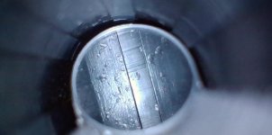

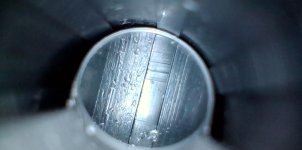

Well thank you Old Cop...but unfortunately, the beer I'm having now is to drown my misery - at least it's a good beer! I've attached photos just taken following S&W's "Performed Service": "Repair Barrel":rolleyes: It doesn't look any different to me, and even if it shot "fine", there's no way a proper barrel wouldn't out-shoot it. And again, for the price, such poor quality is appalling and ridiculous.
I will email them tomorrow with a few questions and to express my dismay. Not gonna worry about it until after the holidays.
Regards to all.

I would have at least shot the gun first to see how it did. I've seen guns with lots of work shoot mediocre groups and I've seen guns with a bore that looks like 5 miles of dirt road shoot cloverleafs. It all depends on the gun.
Earlier this year I bought a Uberti S&W No.3 replica, and the inside of the bore had several cosmetic issues. I hemmed and hawed over returning it, but then when I shot it I discovered it actually grouped better than my other Ubertis. In the end I decided to just leave it as-is.
Not giving advice to the OP here however. Pride of ownership is a significant factor in owning a firearm, and it's hard to be giddy over a new gun with a bore that looks like the surface of the Moon under magnification. Call S&W back and let them know you're not happy with the repair work performed (assuming they even did anything) and go from there.
BTW S&W is no stranger to making poor-quality barrels. I bought one of the first M&P .22 Compacts to be sold, and the thing leaded terribly until I finally ran enough JB bore compound through it to polish up the inside of the barrel.
Looks like they just sent you your old barrel back after paying "lip service" to you and the "repair". You might want to punch some VERY small and indistinguishable (to anybody but you) tell-tale marks in a very obscure location, send the gun back and see if that marked barrel comes back to you...
Looks like it's badly leaded. That's likely due to a rough bore. Use a stainless steel brush and shoot it a lot with copper plated ammo to see if it polishes out. If not send it back for replacing. My new PC 41 has been working well with no issues.
It is not leading; it left the factory that way - twice. And the "uglies" survived two deep cleanings by me. Those flaws are indeed in the steel.
I am emailing S&W to seek a replacement barrel or entirely new Model 41 (that has actually passed some meaningful quality control), and failing their agreement, them simply buying it back from me (I had them do so before on another flub of theirs). S&W is closed for the holidays, so I won't have any news until after the new year.

I am shocked at how S&W is handling this. It looks like steel chips were embedded in the barrel as the rifling was cut.
While relining the barrel is an option, it is NOT an option that I would consider for a brand new pistol! You paid good, hard earned money for a brand new, expensive pistol that is supposed to be a top end target pistol.
What I would consider doing is sharing your barrel photos with either Bartlein, Kreiger, Douglas, Hart or Wilson (well known manufacturers of match grade rifle barrels) and seek their professional opinion as to what you are seeing as damage, and present that opinion when you reach out to S&W CS ... stack the cards in your favor!
If it was my m41, I'd get the barrel relined by a gunsmith who specializes in custom work for Bullseye pistol.
I recommend Alex Hamilton of Ten Ring Precision, Jerry Keefer, or David Sams.
These guys have great reputations and regularly do this work. For serious target shooting most m41s these days need this type of custom work. Typically costs about $200.
