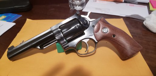

glenncal1, post 4, that's the Ruger I wanted but I ended up buying the 6" GP. Two months later I finally found the 5" Lipsey. I ended up trading the Lipsey for a S&W 629-6. Both are spot on if I do my part.
