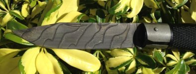

I smeared some hot sauce on my knife blade to make a patina:
Worked well.
