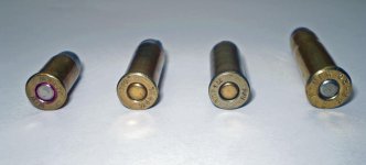

32s are a tricky thing to learn about since S&W used 4 different cartridges in that caliber and all were introduced before 1900. When you mention 32 S&W, that is actually one of the calibers used, plus 32 Long, 32-20 (32 Winchester), and the obscure 320 Revolving Rifle cartridge.
The pictures below show the relative size of each cartridge. The 32 S&W was an 85 grain RN bullet and factory loads ran 700 fps. 32 Long typically carried a 98 grain RN, plus can be loaded with a 96 grain SWC will run 780 fps. The 32-20 is a snappy round when loaded with the standard 100 grain RN that will get close to 1000 fps. The 32-20 was originally a rifle cartridge that was loaded to over 2000 fps, so you had to be careful in the first half of the twentieth century to get the right factory loading.
The good news is that all but the early revolvers were stamped with the calliber, so identification is quite easy on most post-1900 guns.

Gary: I think you skipped one cartridge, the .32-44 target round for the New Model 3. It has a cylinder length case with the bullet seated below the case mouth. So far as I know, it was never chambered in a hand ejector.
I have always been confused by that cartridge. I assume it is different than the 320? I do remember that the 32-44 target was loaded by inserting the bullet totally inside the case as with the 320, but never knew if there was a difference between the two. There is practically no information out there on either cartridge. Barnes book has no information on either caliber.
Gary: I had to get out my NM 3 in .32-44 and another .32 to do some checking, as I don't have a .32-44 cartridge. Here are the measurements I got using a set of plug gauges:
.32- 44
Chamber 0.350" (no taper)
Chamber mouth 0.320"
Bore across lands 0.309"
1903 .32 Target
Chamber 0.340" (no taper)
Chamber mouth 0.314"
Bore across lands 0.302"
There is a shoulder in the .32-44 chamber, and it appears to be at approximately the same length as the .32 long shoulder, so I was wrong about the case for the .32-44 being cylinder length.
