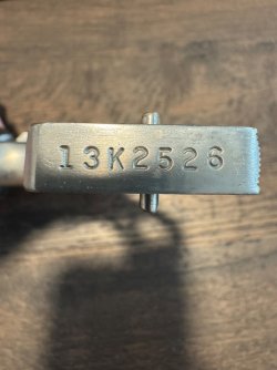

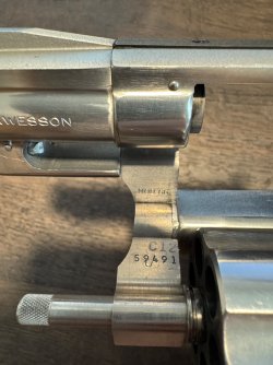

Hoping someone might be able to help me identify and give some insight on this Model 66 I inherited.
Model and Serial is in the yoke.
Mainly curious to know rough production year. I’ve searched several forums and can’t find any that match the description of this one in terms of number digits.
Any help would be greatly appreciated.

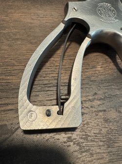

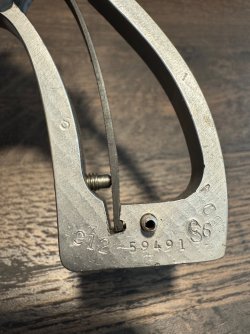

Let me state this plainly the number in the yoke is NOT the serial number! Common mistake. The number on the butt is. Intermittently smith did put the serial in the frame cut under the yoke but for clear identification and communication S&W ‘s should always be identified by the serial number on the butt
Very nice Model 66 'no dash' with a 2/12 inch barrel, a desirable configuration. Also has very nice K frame round butt finger groove target stocks with excellent figure in the wood. Either one is worth serious money, but I guess you knew that being a forum member.

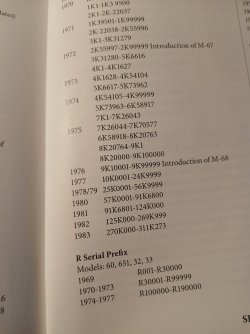

I bought this one in early 1974. $157 and a few pennies. Serial number 6K65XXXX

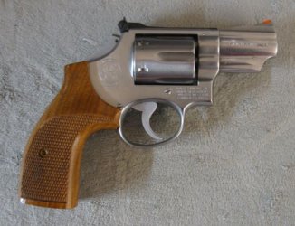

I recently put on Herrett Shooting Star. Trying to decide if I like them. I think so.
