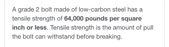

As an example: ( Photo 1) Grade 2 low carbon steel has a tensile strength of up to 64,000 psi. However, Grade 2 steel is what we use to manufacture bicycles. NOT MOTORCYCLES, bicycles.
If you were to use a GRADE 2 BOLT to construct a car engine, the result would come apart seconds after you started it.
Final product strength is what we should be focused on. So, how strong is an antique firearm? That's the real question.
