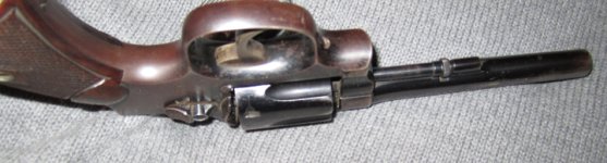

Need a value of this S&W Special 38 CTG Heirloom Patented 1908 - 1914 Can anyone provide a value of attached S&W Special 38 CTG Heirloom 1908 - 1914. Serial #50xxx8 I really don't want to purchase a book for it's value. Hoped someone would be able to assist. Thanking you in advance.
CarTridGe - an abbreviation in the caliber designation.
You have a Military & Police (Model of 1905, 4th Change). This is a very common gun as far as S&W's go. Yours dates to about 1926. Condition doesn't look to be all that terrific, and combined with its being relatively ubiquitous, I'd say your revolver is worth $200-300 (retail) as a shooter, provided it is in good mechanical order and the bore looks better than the exterior finish. Don't expect collectors to be be lining up for this one, although it does at least appear to have the original stocks.
