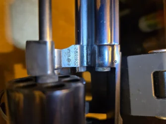

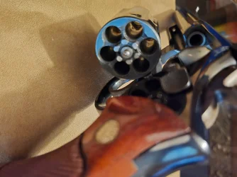

If you get a chance perhaps u can post some pictures?
Photos attached.
