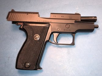

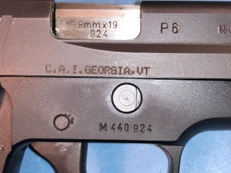

This Sig P6 was imported by Century Arms International ("C.A.l") in Georgia, Vermont of all places. C.A.I. was a subsidiary of Century International Arms ("C.I.A"), however, importing German arms with a C.I.A. inscription was asking for too much attention, so the company word-smithed the inscription to C.A.I.
IMG_8493 copy.JPGScreenshot 2025-06-29 at 7.59.00 AM.pngScreenshot 2025-06-29 at 7.59.32 AM.pngIMG_0394 copy.JPGIMG_0386 copy.JPG
