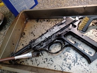

I've had a few guns come in to be refinished that someone spray painted. I used acetone in a covered metal container to remove it. Don't use plastic or Tupperware it will melt it but it won't hurt blue or nickel. Hopped contains ammonia so don't soak it in that. I refinished a badly neglected 70 series Colt Government model and used nickel stripper which worked quick but was left with a copper flash plating. I soaked it in ammonia for like a week and the copper disappeared. I'm not sure how S&W plated their guns but ammonia will remove copper. Once you get the gunk off see how the springs react. You say the rounds didn't cook off? It doesn't take much heat to get them to do that. I was drying some brass in an old oven at 350 and I heard a pop. Yes somehow a loaded round was in there.
I would recommend a month or two in a bath of Ed's Red. A .50 caliber ammo can works well for soaking. Pull it out every couple of weeks and brush it with a stiff bristle toothbrush and plop it back in.
The right stuff would be Ed's Red, a combination of Automatic Trans Fluid and Acetone and something else. I can't recall the correct formula. Hopefully someone will be along that has it. To work today I'd put in a sealed container of Kroil. Kroil is s penetrating fluid and will not harm any part of the gun. If possible get the grips off the gun first.

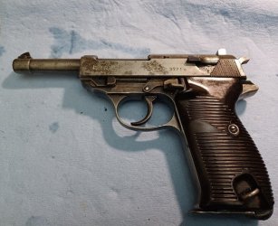

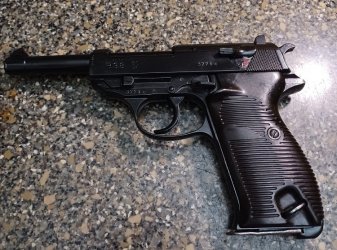

Similar experience, on a Ruby and a P38.
Straight Acetone in an aluminum tray was my juice, Ed Red which contains Acetone probably also work.
