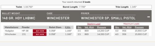

Different charges can be caused by several things; different powder lots, different operators/ loaders, different bullets, different brass, and different primers. 231 and HP-38 are certainly the same powder. Industry variances in burn rates for different powder lots of the "same" powder may be somewhere around an allowable 3% - 4%, a good reason to buy powder in larger containers than the 1 lb. versions, unless you're just looking for a powder to try.

HP-38 and W-231 are definitely the same powder. The variations in load data you see from one manual to another are the result of the use of different primers, brass, bullets, firearms. Differences between HP-38 and W-231 from the same manual can be due to variations across different powder lots.

It is the same powder. I use 231 when I was unable to find HP38.

W231 is identical to HP-38. W296 is the same powder as H110.
