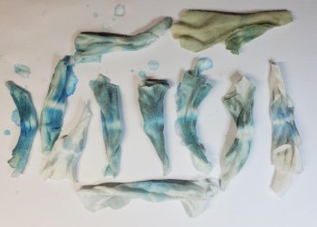

About 3 months ago I was watching a YT video of a guy using Hoppe's #9, then using Bore Tech Inc's Cu+2 Copper Remover in his bore of an AR15. I was very surprised at how much copper comes out onto the patches. I tried it on already "cleaned" rifle and was blown away how much copper was dissolved coming out the barrel bore.
I've have now switched to Cu+2 Copper Remover on all parts because it cleans so well on carbon and ammo residue, and especially copper out of the bore. I run a wet cloth patch through bore and let set for about 5 or 10 minutes, then do it again until there is very little to no "green" copper coming out on the patches. It has no ammonia.

"Hoppes does dissolve copper."
Hoppe's #9 may remove or dissolve copper, but my fresh bottle of Hoppe's #9 Gun Bore Cleaner will not come close to what Bore Tech's Cu+2 Copper Remover has done to every firearm I have recently cleaned.
Based upon the green-blue color on the cotton swabs, assuming that is dissolved copper, Bore Tech's Cu+2 Copper Remover is doing an incredibly better job at cleaning copper from the bores.
