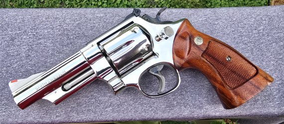

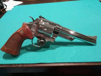

Here is a 29-2 that I cleaned up. It spent it's previous life in a presentation case that must have retained some moisture. The flocking on the case disintegrated like they all do, leaving a speckled nickel finish behind. Unfortunate because the gun appears unfired or nearly unfired as it hardly had a turn line. I got most of the freckling out, but again, don't expect to polish out anything deeper than a swirl mark. Note that the before photos suck. The brass color in the before photos is glare and oil. If you see gold like that that isn't oil or glare, the nickel plating is gone in that area. Same gun, two different sets of grips in the after photos.
