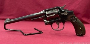

Groups? Nothing to write home about. 15 yards, minute of baseball. I replaced the center pin with a new one. Definately tightend cylinder play out caused by just that. Still waiting for the proper cylinder stop to show up somewhere. There is a source seller on the net that has it, but I absolutely will not be knowingly scalped. Price? 48.00 American. So, still working toward that holy grail of a good grouping load. I don't even know if these revolvers are capable of golf ball size groups a 15 yards. A good rear sight would go a long way in improving the revolver accuracy.
Try some 115-120gr .314 bullets with your HP38 3.5-4.0grs. I have a 1905 1st change target that may have been unfired when i got it. It shoots that load into a golf ball at 25yds from the bench. Most of my 32-20s will do that a 15 yard. However some of the more worn ones wont. I can get the more shot out one to shoot with 100gr XTP’s. I know it accelerates wear but so what it wasn’t hitting the target in the first place.

I've used the first two but the third is a newcomer to me...HP-38 always metered well for me...If I was a betting man, I would bet on HP-38 and the 100 grain projectile for tightest group...Let us know...:cool:...Ben
I bet he is right. I use W231 (same stuff as HP-38) and a 100 grain powder coated SWC from Jerry's up the street in my three 32 WCF revolvers. All of mine like the 100 grain bullet better than lighter ones or heavier ones.
