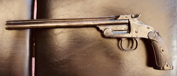

Thank you all for the information provided.
The .22 barrel has the same serial number as the 38S$W cylinder, barrel and stock 11234, but not the receiver. It is a relic that has been in the family for decades, great-grandfather, grandfather, mother, according to the story (my story) great-grandfather won it in a shooting contest.
P.S. As soon as I can, I will upload photos.
Photos?
Waiting patiently for the photos of the serial numbers.
Murph
