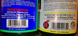

Few pictures of the same lot number from Winchester and Hodgdon.
How to read the lot number.
First number is the weight of the container it's sold in.
Next six numbers is the date the powder was made.
Last four is the lot number.
1 - 1lb bottle
07 - Month of July
16 - Day
14 - Year 2014
2427 - Lot Number

Not according to Hodgdon. I asked the same question and Hodgdon explained to me, they come from the same hopper. How can they be different. Only difference is from lot to lot.
Historical chemical analysis shows they once had slightly different chemical composition, perhaps because they were once made by different powder manufacturers.
They were always intended to be the same powder functionally.
The different labels reflect exactly what is going on in this thread . . . people refuse to believe they are the same powder, and continue to use W231 because they always used it.
As you mention, they now come with identical lot numbers because they are packaged from the same powder lot. The ONLY difference between the two powders is price. Hodgdon pays Winchester a royalty to use the name, so W231 costs more at MSRP.
