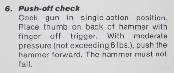

This is from the S&W Armorer's manual, the closest thing to a "set standard" I can find....straight from the horse's mouth, so to speak:
After confirming weapon is empty...."Cock gun in single-action position. Place thumb on back of hammer with finger off trigger. With moderate pressure (not exceeding 6lbs) push the hammer forward. The hammer must not fall."
If you're having a hard time "quantifying" what "6 pounds" of pressure is, hook your trigger pull gauge on rear of the hammer and pull forward until you reach the 5-6 pound mark on the scale. Remember...... do all these tests on the internals with the sideplate on.

Thanks. Guess I should switch to 5lbs instead of the 10 I have. I'll go push on a scale and see what 6lbs feels like. I'm betting it's not much at all.
