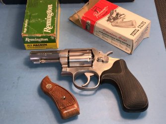

I have a factory bobbed K Frame and never an issue. Closest I can come to a J Frame.

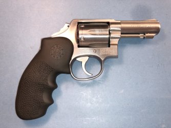

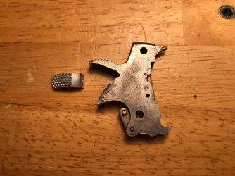

Bobbed the hammer on the K-frame 65-3 heavy 3" barrel .357 magnum. A favorite 80's FBI carry option. Acquired an as-new example, found a new hammer replacement to bob; dremel cut-off wheel, grind sharp edge, polish, done. Filed off single-action notch so its double-action only.

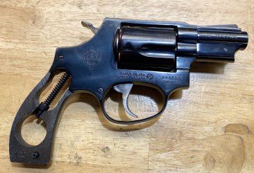

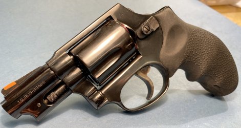

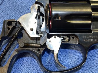

On the J-frame I bobbed a Taurus M85, filed off the single-action notch as well.
Functions perfectly.
