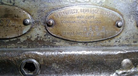

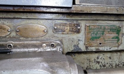

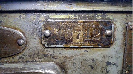

As to why MRC adopted this "hand lapping" (identical to that done by the other barrel manufacturer in Kalispell), it was probably because they had allowed their Springfield Armory Pratt & Whitney gun drills and reamers to get into horrible mechanical shape by not doing regular maintenance as has to be done with any production lathe, milling machine, etc. Kind of like deciding you never have to change the oil in your truck, just keep running it.
Those Pratt & Whitneys had started out at Springfield Arsenal making barrels for US military weapons during WWI; the brass WWII arsenal tags were still mounted on the bases. They had been making barrels for the US military through two world wars, Korea, Vietnam, etc before being sold off as surplus. They were making 3,000 AR-15 barrels a day for Remington after they bought the barrel division off Brian Sipe for their AR-15s.
If I had known the sad things that were going to happen with the new company and what was going to happen with those drills, I would have taken those tags off them to add to my collection of interesting things. But all I have is pictures...
