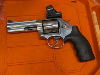

Here's my 686 with a 507 Comp the previous style EGW mount (the new one covers the front screw hole and extends the optic further back). It and the Allchin mount are probably the two most common S&W revolver mounts, neither allow use of a rear iron sight.
There are some more boutique gunsmith options that include a rear sight, but that won't be of help to you in Australia.
I still think that the LPA rear with another brand front would be an option for you, provided you can get the options I mentioned. Perhaps LPA will tell you the height of their front if you ask.
That being said, if it's just a range gun, I don't think that running dot only is a big deal given the durability of modern optics.

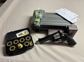

I've picked mine up, ready to take it for a shoot as a stocker
I think the LPA rear only for mine in black is a WXT0407
