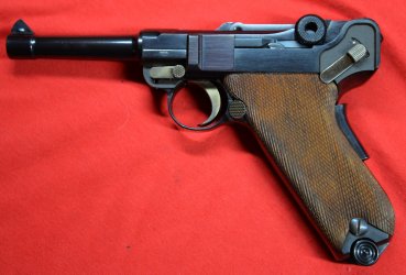

The Parabellums from the mid 1970 are the 29/70 and they are not built on the more common 08 pattern but the 06, just like the Swiss pistols.
Great shooters with much better metallurgy than the guns from the DWM era.

They were actually built using the old tooling purchased from the Swiss government. After Mauser concluded their production in the 1970's they destroyed the tooling. Any Original Mauser's in the standard P08 style were reworked WW2 guns.
