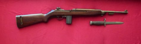

Only one in the safe. IBM M1 Carbine Winchester USGI Stock.
Photos 1 and 2: National Postal Meter.
Photos 3 and 4: Underwood. I believe the W on the receiver indicates the receiver came from Winchester. Carbine has flip rear sight, high wood and no bayonet lug.
Photo 5: Underwood metal in a reproduction M1A1 stock.
