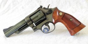

Model 19 experts:
A while back I can into a well-used but still tight, and very accurate, Model 19-3 with a 4” barrel. Ser. # puts it about 1971-ish.
However, it was wearing aftermarket grips. They’re okay but obviously not factory. I’d like to find what would be the ‘correct’ grips - same as what any 4” 19-3 of that era would’ve worn coming out of the shipping box.
I’m seeing a lot of model 19 S&W factory grips floating around at gun shows, on eBay, and the auction sites. All in various conditions of wear and use, from nearly pristine to beat-to-snot. Some are square-butt, some round-butt.
What am I looking for? SB, RB? I’m okay with an honest amount of wear (not abuse) since a pair of *somewhat* worn grips would actually match the condition of this revolver.
Pics, if you have them, would be helpful in my search!
Thanks in advance.

The 19-2 was made from 1961 to 1967. The diamond was deleted from the stocks in 1968. Assuming a square butt, the correct stocks would have been the diamond centered football relief stocks, as shown in pics. Model 19 came standard with target stocks.

If it is a standard 4" square butt model 19 from 1971, no question it would have had checkered Target stocks, Goncalo Alves, "football" or extractor cutout, no diamond. Figure $75-100 for an appropriate set.
If it's a -2 the serial number would put it earlier. If the serial number makes it 1971 it should be a -3.
I would think a 4" would have a square butt but have seen plenty of 4" RB so not sure which yours is.
See OP as EDITED ... I screwed up, guys!
SNW19 is correct. My mine is a 19-3, not -2. Apologies for the confusion.
Everything else in the OP still applies. ... Yeah, I'm confused on the SB v. RB for 4" 19-3s.

This one is within a couple hundred numbers of Frank Black's. I've always found it interesting that the Model 19's that came with the standard Service Trigger and hammer had the Target Stocks installed rather than Magnas which you would usually see on guns that didn't have a Target Trigger and Target Hammer.

As others have stated a 19-3 is different than a 19-2, although they look identical to the untrained eye the rear site units don't interchange, the 19-2 is from the diamond stock era where the 19-3 was the first to get the then new non diamond stocks, they will both fit either gun but most want period correct.
The Combat Magnum was an upscale model and was introduced in 1955-56 with a 4" barrel only and target stocks , the 6" version appears around 1963 IIRC with target stocks followed by the 2.5" snub round butt that came with the smaller Magna style as it was primarily a concealed carry gun.
In the earlier 50's and 60's versions the target stocks could be made of Walnut, Goncalo Alves or the less frequently encountered darker Rosewood, most were checkered but some were smooth "aka presentation" style.
With the introduction of the Combat Magnun SW began cutting a football shaped relief cut to add some clearance for extraction of cases.
This changed to a "Speed loader" cutout sometime in the early 80's IIRC.
A 4" 19-3 from the 70-72 era would most likely have non diamond checkered GA targets IMO.
Walnut stocks were avaiable at that point but I think of them as being more likely found on non Magnum K target revolvers.
SB Magna stocks will fit if you prefer buy not be correct as it came from the factory.
Note as with everything SW there were always exceptions to the rules.
If your gun is high condition and you want to show it off I like the presentation style as they show the wood grain much better.
