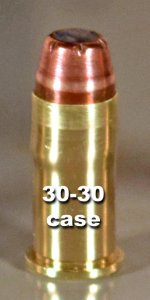

The next step was with a 30-30 case. The diameter above the rim was perfect for a 610. Used a tubing cutter at the area where the powder would normally be to rough length of a 10mm case. Trimmed it to length to 10mm case length spec. That modified 30-30 case chambered well in the 610. The concern was the thicker wall dimension of rifle brass and once a bullet was pressed into it, would it become too large in diameter to be chambered.

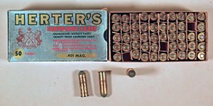

Eventually 401 powermag ammo/brass was found to be a perfect candidate. 401 Powermag was a short-lived production for revolvers with the ammo distributed by Herters and manufactured in Sweden. Needless to say the ammo was extremely rare and the search was on. Being that I go to a lot of gun shows, always looked for that obscure ammo. Most/all never heard if it. I've seen it on auction sites but wasn't about to go that route. Two Akron shows ago I asked a table/vendor of misc stuff and he heard of it and he believed he had some. The last Akron show he brought it in for me. A full 50rd box of ammunition.
Project back on.

Disassembled 10 cartridges for evaluation. 8 of the 10 were sized thru the 10mm die, no 'sizing' was performed by the die, they were perfect as is. Put 6 new Winchester 10mm cases into a moon clip and measured how much/length was actually in the 610 chambers. Used that dimension plus the rim thickness to trim the length. The modified 401 mag cases chambered well in the 610.

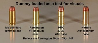

Made 3 more pieces each of the 41 Mag and 30-30 for dummy round visuals and sectioned/cutaway visuals.
Eventually I'll make up 6 loaded rounds with the modified 401 Powermag brass for load/pressure/chronograph testing.

Aligning the cutaways of 10mm and the 401 case and matching where they would sit (10mm in the moonclip and 401 case against the cylinder), the powder capacity appears to be less with the 401 case.
I'll use my 10mm reloading data (backed off of course) for when I eventually start testing for pressure and velocity with the chronograph. I don't expect better ballistics over a standard 10mm, actually should be less with reduced powder capacity.
