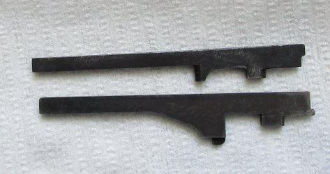

BTW, the Marlin 1891 and 1892 in 32 caliber will fire 32 RF and 32 CF. All you have to do is remove the side plate and swap out the firing pin. Top-1891 RF, bottom-1892 CF. They both handle the short and long 32 Colt RF/CF. Unfortunately it's all very expensive ammo. 1897 shown.IMG_1151 (2).JPGIMG_1879.JPG
