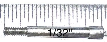

Put this here because most Smiths love math and have the dexterity when working with little parts.
Picture of threaded rod that appears to have 7 peaks over 1/8".
Threaded part is 1.7mm in diameter.
Shaft of rod is 2.0mm and a head that's 2.4mm.
Found this math to convert TPI in inches to Metric.
It appears to be 7 threads to 1/8" so thats 56 TPI.
Hope that's right.
Divide 1/56 = .01785714 and multiply that by 25.4 = .45357143
That might be a M1.7 x .45 metric screw.
Have found M1.7 x .35 metric dies but no M1.7 x .45 metric dies or taps yet.
My mill can work as a small vertical lathe but not for threading.
Anyone know of a source for an M1.7 x .45 metric die?
Thanks as always,
RT

The major diameter is 1.7mm/.0699" and it was made in Paris around 1860.
I get measurements of 1.67mm-1.7mm on the threads, as it's old but the rods/threads are in nice condition, and only one needs replacement, as the threaded portion broke and is short.
Still has enough threads to be used, but when doing a restoration, best to do it thoroughly.

That is better than the M2.2x.45 die and less expensive than buying a screw cutting lathe. :D
Will have to get in touch with Victornet and see if they have an ETA on the die. Taps are in stock.
Some others have the #1-56 die but no taps.
Will keep checking and may order two taps from Victornet, plus some other stuff, to make their minimum.

Found a supplier with #1-56 adjustable dies and taps in stock.
Will post their info once I receive those items and see if they are of good quality.
